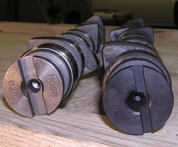

You can use MK4 cam in a MK3 because the vacuum pump is driven from the intermediate shaft in the block,not from the camshaft.TDIMeister said:None. First of all, the Mk4 TDI cam has the same specifications as the Mk3, and second, you cannot interchange the cams between generations without machining modifications.
See picture. Left -- Mk4; right -- Mk3

True.TDIMeister said:The slots also serve for alignment and fixing the cam timing.
