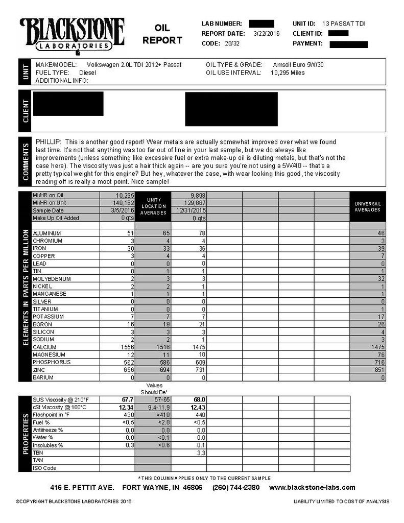

Old March 22nd, 2016, 19:28   #3374
pkforbes87
pkforbes87's Avatar
Join Date: Aug 2015
Location: Hollister, CA
No, I'm not using 5w40. Anyone else using Amsoil Euro 5w30? Is it just a little on the thick side?
The aluminum concerns me a little, but I've been told that's normal on common rails without an EGR delete. Living in CA, there's no EGR delete in my future.
pkforbes87 is offline   Reply With Quote
