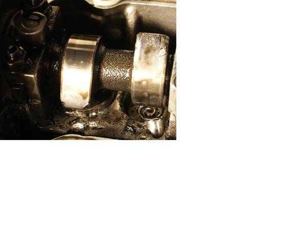

You're right on the money. I pulled the cam cover right after I posted the last response, and found cylinder one had eaten a valve. I suspect that it probably contacted the piston as well, as the damaged valve is recessed into the seat a good ways.
Is this normally a wear and tear thing, or is it likely something else broke and caused this damage?

Cams do wear on these, taking the cam follower with it. Not many fail, just some. Sometimes the damage is limited to the cam and followers, which can all be changed out quite easily. If the tip of the valve stem or the cylinder head casting (aluminum) is damaged, then the cylinder head must be pulled for repair.
Are you sure of your nomenclature? The valve and seat are only visible if you have pulled the head. Have you done that yet?
Can you post photos of the #1 lobes and followers?
it is likely a botched tb job (see post #4)

I'm sure I'm misusing terminology. The lobes are definitely damaged, and the right circular piece (cam follower?) for cylinder one that goes into the head has it's top broken off. Sorry for not being more technical. The top of the head in front of the cam is damaged as well.
I'm trying to figure out how to make the pictures I took small enough to upload. Right now I get an error message stating they're too large.
I used a different mechanic to do my last timing belt change. Looks like that was a mistake!

Here's the damage:
Any opinions?
