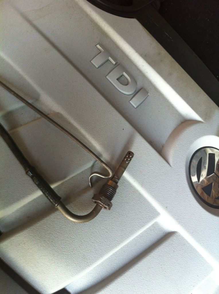

Originally Posted by 2micron View Post
Hello all, Here is a simple guide to help replace your G235 Temp sensor, Bank one. It is a 2-3 hour job at home, on ramps and you will need the special tool, (VW #T40055 or Snap On #FRXM-17) mentioned above.
I recieved a flashing Glow Plug and a P0544 code.
VCDS will tell you G235 and which Bank is faulty.
The Part number for my VIN was 03L-906-088L.
This is the sensor with the Black Connector, which is easy to locate the connector portion. Your G235 Connector is the black one, below the Orange Connector.
The threaded portion of the sensor is just below the Turbo, threaded into the Exhaust Manifold. Not a very friendly location!! (Item#37)

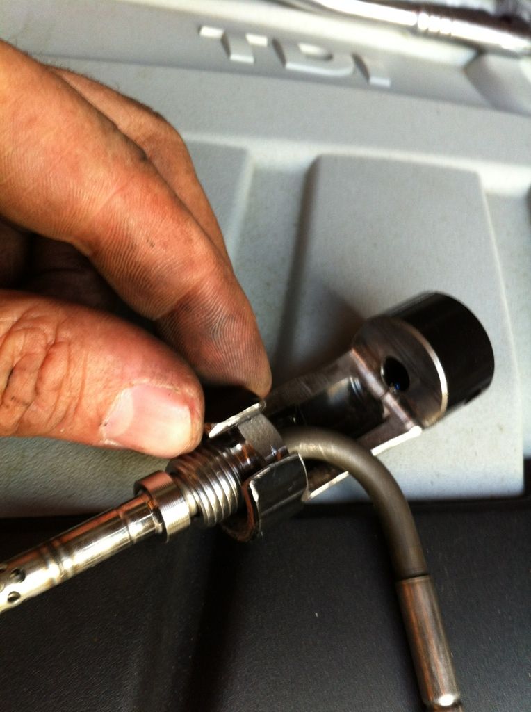

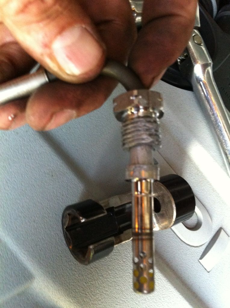

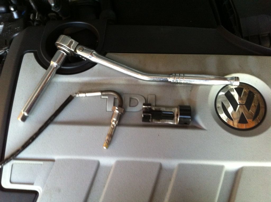

I didn't have time to wait for the special tool, (VW #T40055 or Snap On #FRXM-17) so I simply modified a 17mm deep 3/8" drive impact socket. You can do this with an angle grinder and cut off disc.
Here's the new sensor and it works best with a flex head ratchet and 6" extension.
The easiest access is from above, once you locate it!!! You still have to remove the belly pan and access the bottom to route the wires properly.

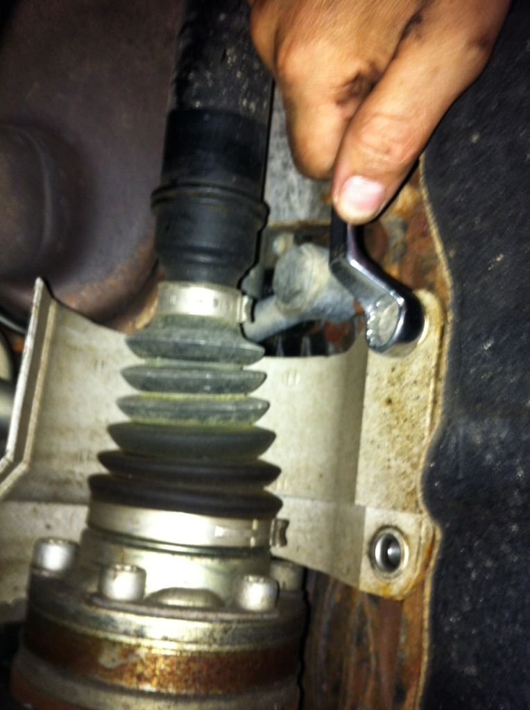

- pay attention to the routing from under the car!!
I removed this cover (17mm wrench) to help see the wire routing:
- fully seat the socket and remove sensor from above.
- coat the threads of the new sensor with high temp thread anti-seize. Do not get any on the sensor tip. Avoid touching the tip, similar to the cautions you use with headlight bulbs!!
I struggled to get the sensor in from the top. I made up this Push Stick from a coat hanger to guide and insert the sensor from the bottom:
Make it about 12" long!
Up she goes!!
- Tighten the sensor from above, ensuring the angled tube is not touching the oil line. Official Torque is 45 Nm or 33 foot pounds.
**you have to re-index the socket every 1/3 turn, so the angled tube doesn't contact the socket body!!!**
