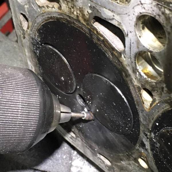

I removed the valve cover and 1 valve was destroyed. The others looked fine. Timing belt was tight appeared not to have jumped... I need to remove the head. I couldn't find a valve12MM TRIPLE SQUARE CYLINDER HEAD BOLT TOOL locally - autozone, etc. I ordered one online. Should be here Monday.
superhl is offline   Reply With Quote
Old December 11th, 2019, 15:48   #111
superhl
Join Date: Jul 2017
Location: 27534
Heads and Piston-
Still can't determine why there was interference. Sending heads to Frank.

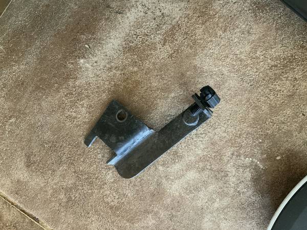

No doubt timing moved... Anyhow, I completed timing belt installation. I quadruple check the timing to ensure timing is correct. I used coat hanger(removed glow plug), crankshaft and harmoic balancer to verify TDC. I wish while I had the heads removed. use the VW tool to place a mark on flywheel. Would make timing much easier... Where does this part go?

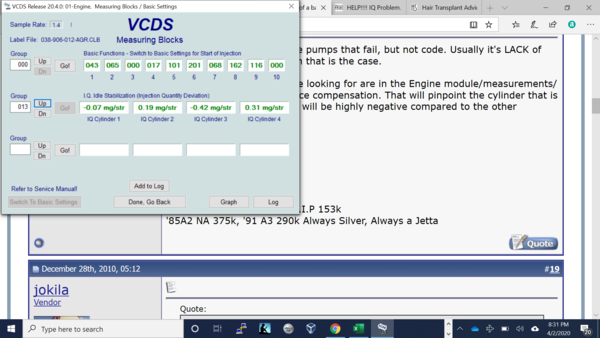

Truck running fine but taking to long to start. No doubt it is worse. Does not matter cold or hot. In the morning, if I turn on my inline fuel pump and let run for 2 minutes, it will start quick. From the tank to inlet of the fuel filter, fuel doesn't leak down (valve prevents fuel from leaking down to tank). It appears I'm losing prime at the injector pump. Not sure! I replaced the head seal on the injector pump about 2 months ago. It really has been an issue since installing the engine. Is the IP leaking down? No external leaks! Is it an injector? When I bought the car, it had been in a collision that knocked the lift pump bottom off. Later Motohead1 says 2002 vw 1.9 TDi did not come with a lift pump. I thinking they must had trouble starting and installed a lift pump. Looking at the VCDS, should all 4 cylinders specs be similar? Cylinder one is substantially lower than the other cylinder
