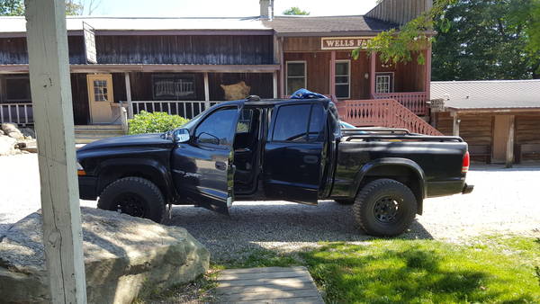

Road trip report
We took the diesel Dakota on a week long road trip to see some family in the peoples republic of new york then over to Erie PA for a wedding. A little over 2100 miles. Truck did great for the most part. Kept getting an overboost code and had to stop and reset it every now and then. Looks like tune needs to be tweaked. Also need a little more intercooler. Will work on that this winter. Bed was loaded to the rim with about 400lbs of stuff the whole time with me wife and 2 turd monsters. I did run about 40psi in the tires as we were on 99% hwy and AC was running about 60% of the time. With just over 3 tanks of fuel burned we got 28.5 to 29mpg. For the load and hills and speed i am very happy with those numbers. Just need to do the gear swap and bigger intercooler and will probably add a .5 mpg to a trip like this.
Caint believe I dont have any pics but one at a ranch visiting some friends.
Motohead1 is offline   Reply With Quote

Originally Posted by Motohead1 View Post
Road trip report
very cool ... confidence building trip for sure... one thing you can do to reset limp mode without stopping is to just cycle the key, don't touch the clutch or knock it out of gear, maintain throttle position with your right foot, just simply cut the key off and right back on ... that momentary blip will clear limp mode (not the stored code) and you'll hardly skip a beat
truck looks great BTW
