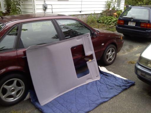

Originally Posted by Mcgink View Post
Work on the Interior swap for I-Red continued with the recovered headliner install. I'm not having any luck at all finding pre-molded carpet for the B4 or any other Passat for that matter via Yahoo search. Does anyone have any leads?
How did you recover your headliner and what did you use?
bonham123 is offline   Reply With Quote
Old September 23rd, 2010, 07:06   #70
Mcgink
Mcgink's Avatar
Join Date: Oct 2004
Location: South of Boston MA
I brought The board to Art's Seat Cover in Brockton and they recovered it for me for $130. That included the sunshade for the moonroof as well. He would also be able to get the fabric for you if you prefer to DIY
