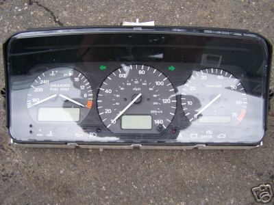

Does your current cluster have 2 retaining screws (in the 3 and 9 O'clock positions) in the middle of the speedo and tach faces like this?

No , none of my clusters have that setup all 3 clusteres 2 glxs and my tdi have no screws holding the faces on. I also have a 95 glx at another location im not sure on that cluster.
The 1995 B4 cluster uses the screws on the gauge faces, and the speedometer starts at 10 MPH.
The 1996 and 1997 B4 clusters don't use the screws, and the speedometer starts at 0 MPH.

Good catch on the retaining screws! Before I tear the original cluster out, the cluster I have does have the screws on the front and my original TDI does not. Are they in any way interchangable or am I screwed on the tach and speedo dial as a result? -T

The differences and coversion issues between the various cluster options are covered in the article. If yours is an early GLX cluster, it will require the most modification for proper tach and MIL function.
