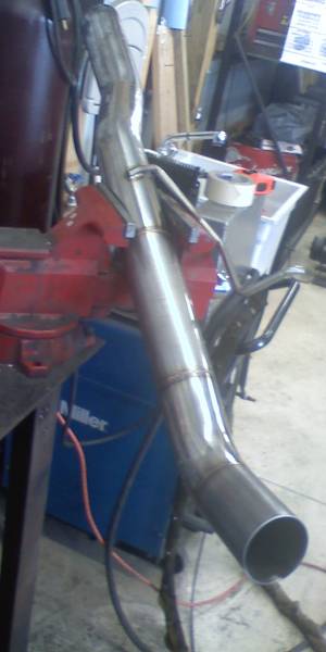

Today (5/18/11), Knurren got the Magnaflow muffler deleted and the 3" mufflerectomY piece that came with the car got extended from Golf length to Jetta wagon length my Matt Whitbread. His stuff is artwork. Love it.

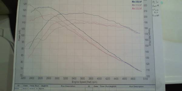

Finally got a photo of my sheet. says 118.6/215 ft-lb on the first run.
This was with my previous RC3+ tune on what is commonly known as a heartbreak dyno.
