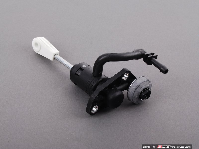

The hard plastic line and 90 fitting are part of the master cyl. There is a grommet at the firewall it goes through. 8D0721495C.
Doh!
I was hoping to buy the retaining clip, the grommet and the 90 fitting separately as I already have the master cylinder mounted, but it looks like just buying another master cylinder is easiest (although not cheapest) route.

I searched for that part number on ECS, IDparts and World Impex and had no luck. Using a 2005 Passat, 2.8l V6 manual as the search criteria on Word Impex, I found the part number 8E1-721-401-AK
I'm guessing is the same thing? No pics though to compare. The weird thing, is it looks like your picture (uberhare) came from ECS tuning, but when I tried to search the number and for "Clutch master cylinder" I had no luck?

The picture I used was as a result of searching 8E1721401AK in google. Any decent supplier should be able to get you one.
