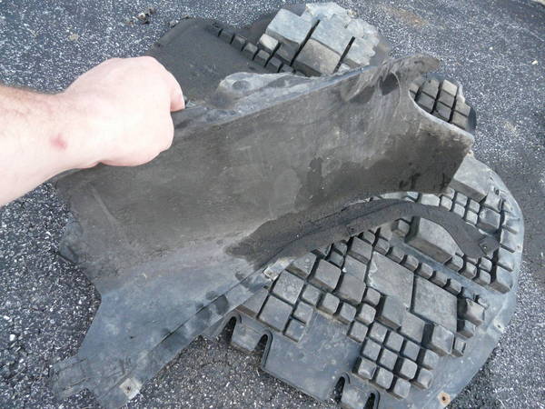

Broken belly pan and side skirts... sigh... I guess I'll be ordering a steel replacement.. Only 5 screws holding it on

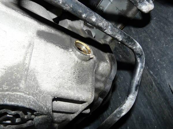

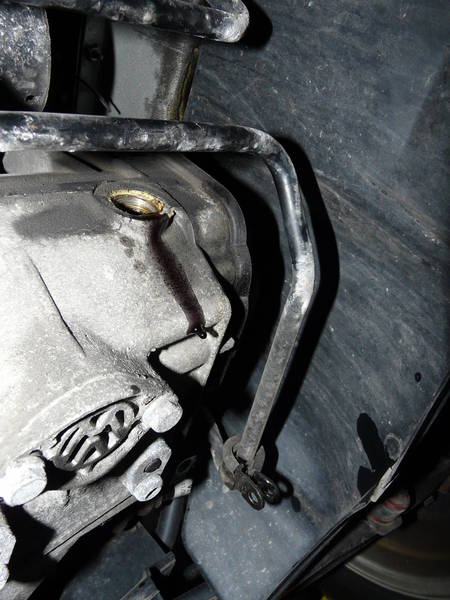

Fill plug removed first, then drain plug as mentioned earlier. I thought I could get away with removing the plug without making a huge mess by holding the catch pan up high but the dirty oil gushed out so fast it splashed up and out of the pan an yes...into my hair, on my face & garage floor. Guess I shoulda listened...huh?

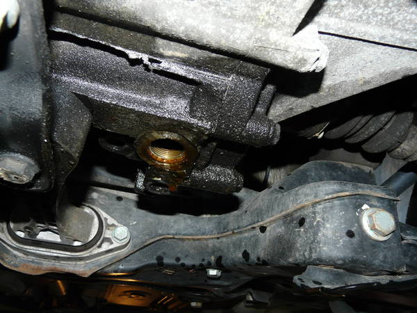

drain plug removed..took two hours for the old oil to stop dripping

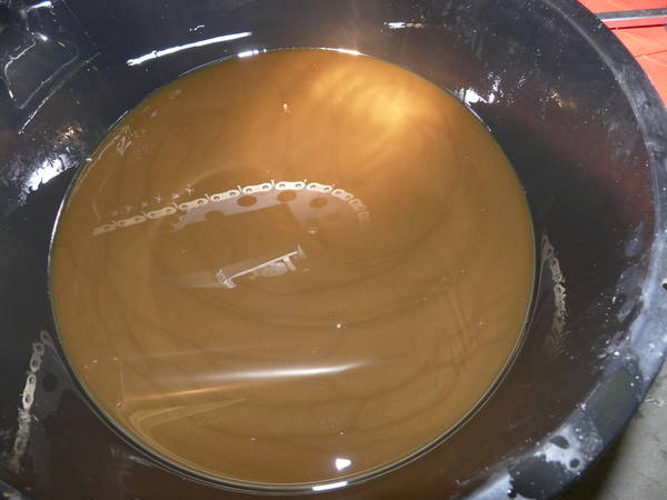

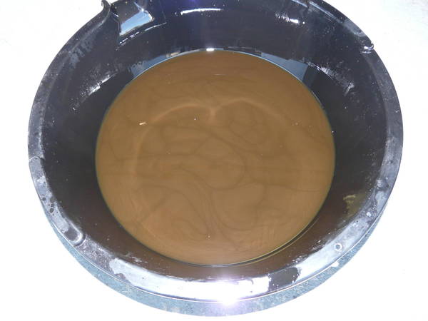

The old oil...
nasty stuff!!

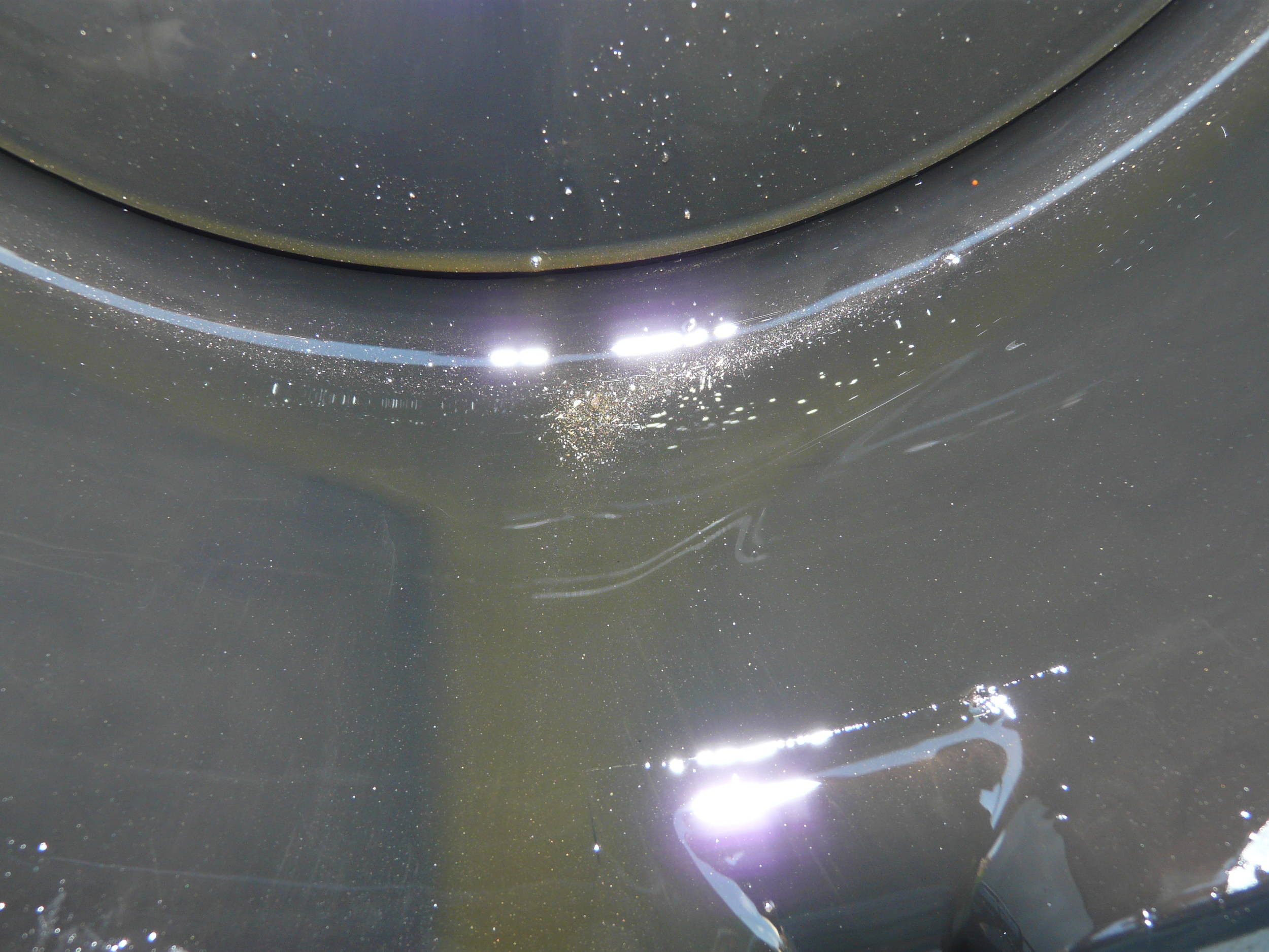

metal flakes at the bottom...I guess that could be expected after 138K miles

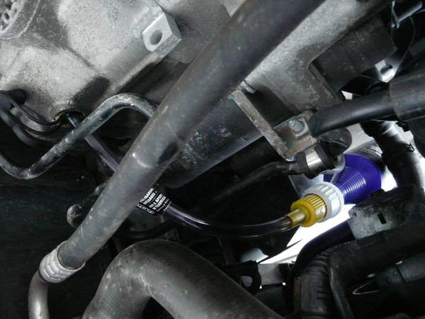

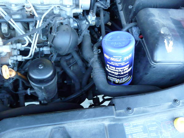

Refilling from the top. I purchased a gear oil refil valve/cap from the local Pep Boys for less than $5..worked like a charm!
twisting the yellow dial starts/stops oil flow.
FULL!
Thanks for the previous hints/tips & tricks! Jacking up the car was the toughest part of this job. If I can do it SO CAN YOU.
BTW, I found a 17MM hex driver at Harbor Freight, it came in 10 piece set for $13.
