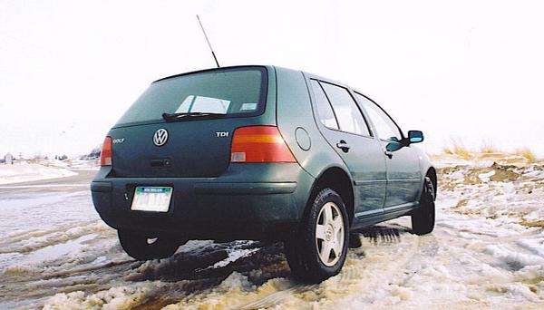

Miss my 03 Golf with the 2" lift. Would love to lift my JSW.
Originally Posted by frugality View Post
This was my 2000 Golf with a 2" lift and stock tires:
wfg97079 is offline   Reply With Quote

I think the 2" lift made for a great snowrunner up here in the northeast too.
