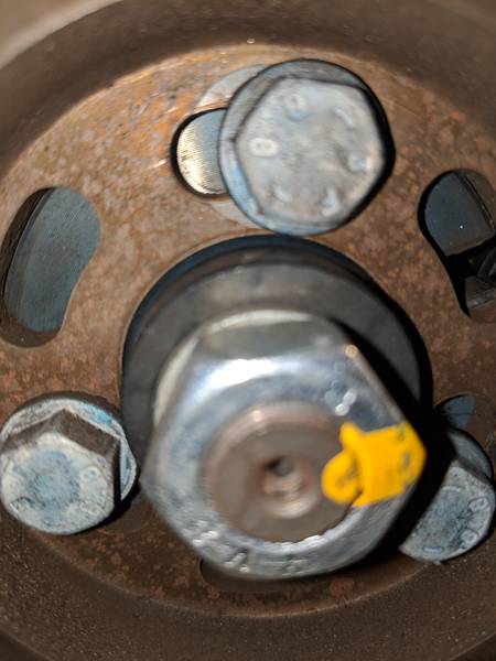

Also, I just got this picture of the...thing I would use to adjust timing if I had the VCDS...It is an exploratory mission at this point. Anyway, it looks like it has slipped. Is this a thing? Is my timing possibly off (timing belt itself is fine/has all of its teeth)?
IF your hub is installed correctly on the pump shaft (and they are from the factory, or from a skilled diesel fuel injection technician using the proper tools and specs), you should be able to get the timing pretty close by just adjusting the sprocket so that at TDC of the crank your alignment pin goes in. Most of the time that is good enough, unless the internals of your pump have worn significantly (drive shaft tang, x coupling, cam plate wear, and even plunger shim wear all lead to "late" timing). The ONLY reason that the injection timing should have to be altered from the pin setting is to make up for pump wear. When I rebuild (or even just reseal) these pumps I always re-index the hub so that it is back to specs, which means that you should not have to tweak the timing.
When the hub is installed to the correct lift spec of the plunger (and nothing else is worn out in the pump), and you install it using the alignment pin at exact TDC, this sets the base timing. This is where the timing stays during engine start up (the ECU CAN NEVER retard the timing later than this point - it can only advance it, but even then, the ECU CANNOT advance the timing during engine start up. This is because the timing advance piston in the pump is hydraulically actuated with pump housing pressure and at cranking speeds there is simply not enough pressure to move the piston (no matter what the ECU commands). My point with all that is that when your base timing IS correct (.85 mm plunger lift at TDC, which is what you get with the pin inserted on a pump with the hub indexed correctly) the ECU takes over from there and can do its thing. When the ECU senses it that it can't do its thing (using input from the crank sensor and #3 needle lift sensor) a correction is required (using software to see what the ECU "thinks the timing is" and adjust accordingly. Again, on a pump with the hub indexed back to new specs you should not have to deviate from that setting.
IF your pump had to be advanced as far as it looks like it may have been from the pinned position, you have some drastic wear in the pump, or the hub slipped on the driveshaft (it isn't keyed), and even if the adjustment was able to go far enough to get it into range that the ECU can work with, you are starting to get out of the range for the hydraulics of the pumping element (discharge ports of the rotor and head have to be rotational aligned at the lift spec for full fuel discharge to be accomplished before the plunger has past that port (and goes on to the port for the next cylinder).
As far as cleaning the injectors, you are correct, it takes special equipment. Most of the injectors sets that I test will have a couple of holes clogged with carbon, which is very difficult to clean. First, you must take the nozzle off of the injectors and keep them straight so that each nozzle goes back on its original injector. Also YOU MUST keep the nozzle needle with its corresponding nozzle body throughout the cleaning process (these parts are mated). The best (and only industry accepted method) is to use an ultrasonic cleaner and a cleaning agent that is effective on carbon (most HD degreasers work). After running in the ultrasonic cleaner for half and hour I reassemble them and test again, if any holes are still clogged, do it again. I have had to run some for 1 1/2 hours to get all of the holes clean.

It is unlikely that it slipped in that direction (opposite the load). If the bolts were not tight enough, the load of the pump would force the slip to be the other way (these pumps take up to 5 horsepower to turn them at full load).
I'm quoting your first post to save space but hopefully get your attention. I'm working through your longer post but portions of it are out of my depth so I'm still chewing on it.
