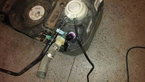

bwk9087
Join Date: Mar 2016
Location: MI
TDI(s): 2003 1.9 ALH
got a few things done. Got fuel filter mounted and lines plumbed from injection pump back to tank, using stock line, and vapor line for return. Made power steering hose, using aeroquip hi pressure hose, and an fittings, I should have taken a better picture of filter, it is below brake cylinder, attached to frame, and I can still get it out to change it from topside.

slow going lately, waiting on supplies, did get a few things done. Got the jeep cam sensor mounted. I did buy a Dakota digital box DSL-1E for the crank sensor, as Motohead1 suggested, in case I decide against my front mounted one, or need to adjust it, or it just don't work.
Got gas tank rollover vent installed, still waiting on fuel filler line, as EVGuy suggested. I kept in tank pump, and removed filter, and placed tee, with check valve in between pressure, and return, to use it as a lift pump.

evguy1
Join Date: Feb 2014
Location: Erington, BC, Canada
I also knocked the big check ball out of the tank inlet. It may not have been one of my problems but anything that will restrict the diesel and cause it to foam is bad.
I think in the end the 1 1/2" fill and new vent were the solution.
I like your vent fitting, what is it?
