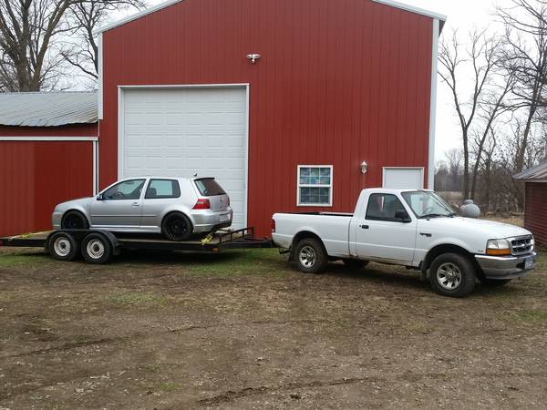

Here's the car loaded up and on it's way to the exhaust shop.

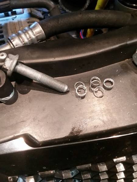

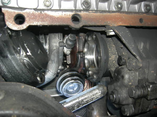

Well Steve at TechnicalDieselInnovations strikes again. This past fall there was more and more soot building up under the hood until it got really bad after we fixed the MAP sensor wiring, we took the car for a spin when a plume of soot came from under the hood.
With me using the car primarily as a track toy, I decided a roll cage would be a smart addition, so with the recommendation of a friend I took the car to Trudell Performance in Green Bay, WI. Besides the roll cage I wanted them to take a look at the exhaust leak and this is where Steve comes into the picture... they got around to removing the exhaust manifold and turbo today only to find that a few nuts were loose on the exhaust manifold to the head. Then it goes from bad to worse...when they separated the turbo from the manifold they found that the turbo gasket was installed incorrectly.
Here's one of the loose nuts.
I'm not sure how the car made 263 hp/ 414 lb-ft with the turbo gasket blocking 1/4 of the turbine wheel. Well hopefully after everything is back together it'll pick up some response and overall power without covering the engine bay with soot.

Nothing to major to report at this time other than Trudell Performance had the interior removed from the car for fitting the roll cage. They also pulled the turbo and manifold due to the incorrectly installed gasket and the nuts coming loose that hold the manifold to the head causing a massive exhaust leak.
They found it was easiest to pull the turbo and manifold by dropping the subframe, which made it a great time to do a few upgrades with the subframe bushings and the clamp that holds the power steering rack to the subframe.
http://www.tyrolsport.com/suspension...rame-bushings/
http://www.tyrolsport.com/suspension...w/mk1-audi-tt/
You can see how the gasket was installed incorrectly on the turbine outlet.
