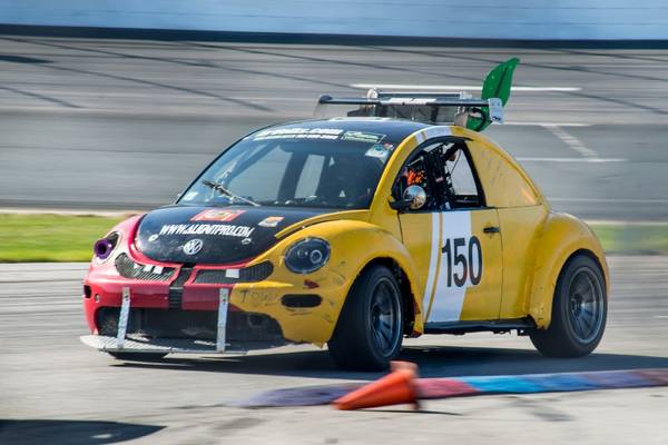

As the only true Roadracing team hear running the Beetle TDI for over 4 years in wheel to wheel racing Chump/Lemon. We have tested every setup that has been posted and made up some of own.
We rework the VW roll center and bump steering
we run a coil over spring/adjuster system all four corners
a LSD
no sway bars
275/40/17 on 10 inch rims
This what most VW platforms look like in a hard turn 70 MPH 2 years back!
Now this is what our best setup looks like a 100+ in to turn 1
We keep all 4 tires on the ground 95% of the time and no body roll!

You removed sways and dialed in your spring rates to counteract body roll such that your net result is great handling with good individual wheel bump compliance.
That was one of the issues with how my 135i was setup. The previous owner had pretty stiff sway bars F&R, which on corners with odd bumps, the stiff bars would cause a little more butt puckering than what I would have preferred. Allowing each wheel to do what it needs to more independent of the others really helps.
