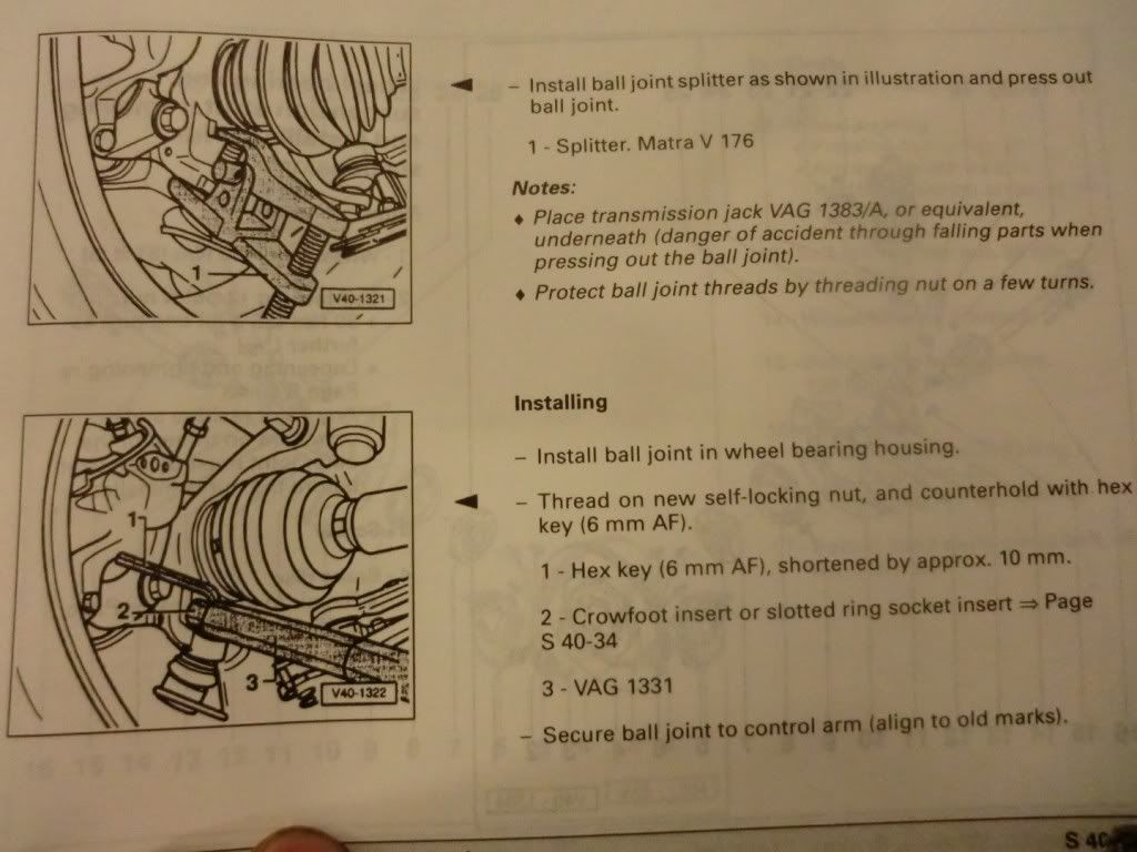

Hopefully the pics will come through

Agreed. I love the design, so easy to replace.
Undo the nut and bolt near the top (the horizontal ones, and you have to remove the bolt completely), then remove the three bolts from underneath, remove ball joint, reassemble with new parts.
Most of the time it's quick & easy.
The second design unthreaded ball joint is great, basically it's a ball joint with no top threaded portion. The one in your picture has the threaded portion on it, and the problem is if the tapered fit comes loose, it is difficult to hold the top portion from spining if the nut isn't all the way off. On the second design, there is a recessed portion on this top piece, and the bolt that goes through horizontally uses it as a keeper, so it won't come off. It also clamps the top portion together, which is easy to spread with a chisel or ply bar making the joint removal MUCH easier. No special puller is needed.

Now looking at mine they don't look like the one above. It seems mine have a part that clamps around the top of the ball joint? Does this mean I'll need the non-threaded ones? Actually I can only find those.

VR6 ("Plus") suspension uses the threaded ball joints.
